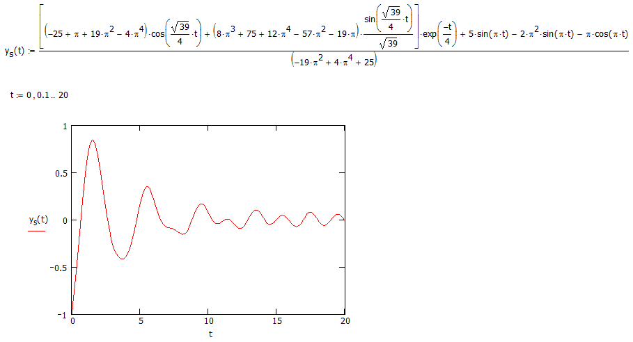

Using some advanced techniques (A classical math problem: differential equations) I've determined that the solution to your DE, for s=2, is:
Maybe this helps.
