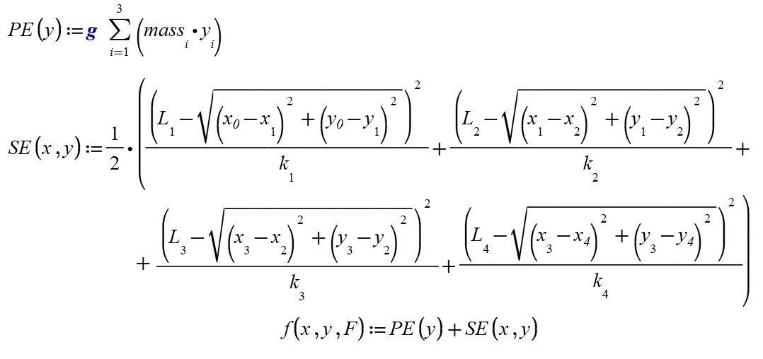

Second task with 3 masses not with strings - with springs
- 13 replies
- 4515 views
- Translate All

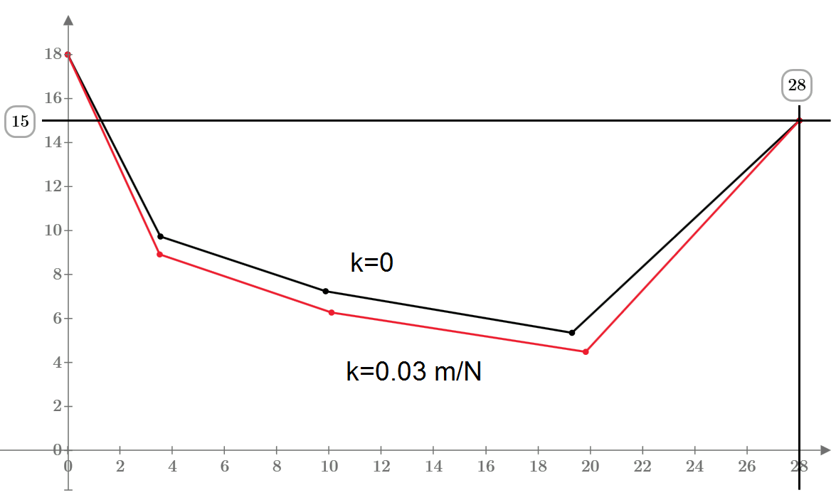

It is continue of One task with 3 bobs - Forces searching
But we have not strings (k=0 m/N) but springers (k>0 m/N)

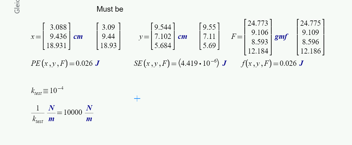

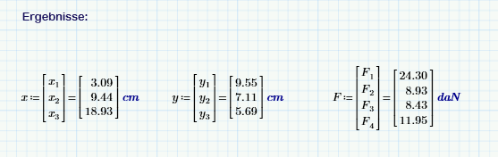

I have solved this new task with using forces analyze - see the picture and the sheet Prime 3.1 in attach.
Is it possible to solve this task by using the Lagrange method - with energy (potential and/or strings energy) minimization (see please the first task)?
