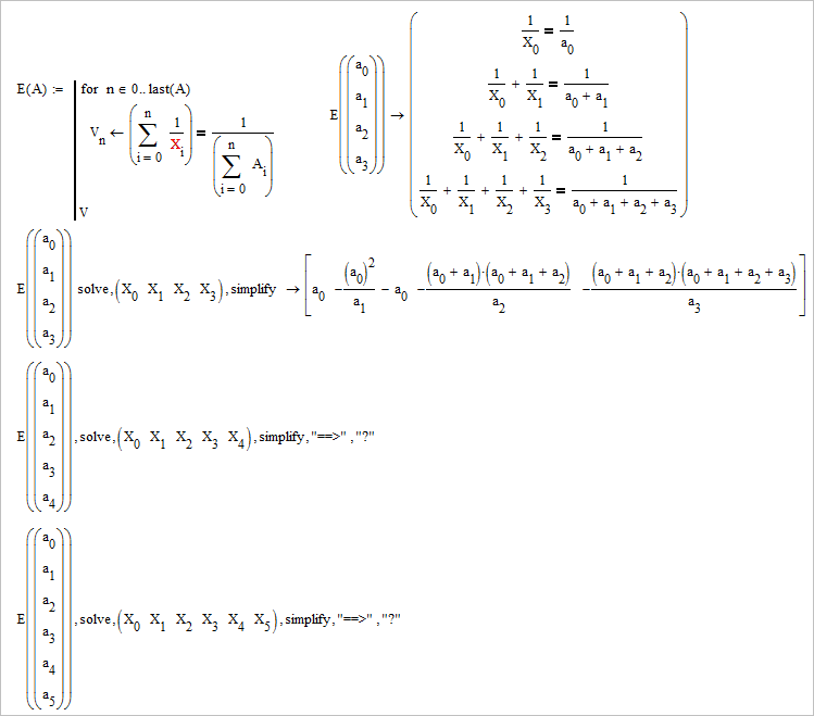

Hello, Everyone.
My question :
Thanks in advance for your time and help.
Best Regards.
Best answer by AlanStevens
Isn't it easier to do it as in the attached?
Alan

Thanks again for your time and help, Alan. From your hint, I got it. ( in the attached )
