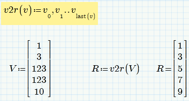

Thank You Werner, is there a way to turn a vector back into a range variable (not that I have an example where I would want to do this, just curious).
February 19, 2015
No and this would not make much sense as the values of a range are equally spaced while the elements of a vector could be anything you like. So conversion would have to fail most of the times.
But it sure is very easy to write a very small function to convert a vector to a range by just using the first, second and last element of that vector:
It sure is a design error that ranges and vectors look perfectly alike in Prime. This can be very confusing,
