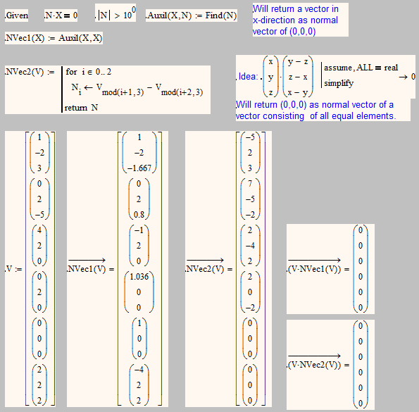

Not sure but I think you will run into some kind of singularity or error with any simple formula.
See attached two very different ways to get a normalvector - both have its drawbacks.
December 21, 2013
Thanks a bunch -- I like that "shorter" idea, Werner -- it allows us to trap only one potential error (i.e., x=y=z) rather than several. It's not perfect, but much faster than our alternative. We're actually just testing some calculations in Mathcad but then implementing them in a scripting language in a different piece of software. SInce we will need to perform this calculations many millions of times, speed is of the essence.
