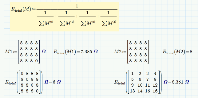

dear ptc community - thanks to mike (num 1) i believe am starting a discussion right - please see attachment and see if someone will comment on it - thanks joe

I am not sure if I fully understand what you need, but I hope that the attached file will help.
I think its best to turn your calculation in a function which has the matrix as parameter.
First routine will work for a matrix with exactly 4 columns only:

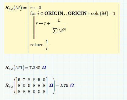

The second routine is more versatile and will take a matrix of any dimensions - columns are speakers/resistors in series and all columns are parallel:

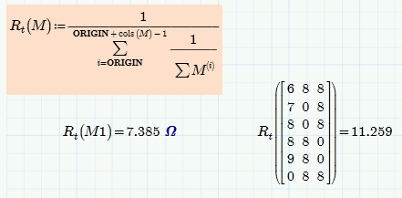

EDIT: Here is a more compact version of the latter:

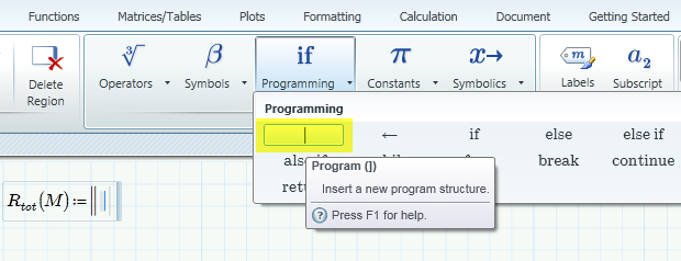

i was delighted to get yur response! however i was not able to duplicate yur 2nd routine(program) - i presume you wrote it in prime 3 - i also tried on prime 2 with no success - my problem is that i cannot enter R[tot](M) as you did - what may be my problem?
I cant't tell from your description what your problem could be as you didn't state what you tried and what did not work in which way. You have to use the programming menu to enter that function definition. Being under maintainance you don't use Prime Express, I think, otherwise programming would not be allowed.
Find attached the vital parts redone in Prime2 format and also a pdf of the original document (but I think my screenshots covered all anyway).
The variable ORIGIN used in my original sheet was just to ensure that the routine would work even if you intend to change that system variable to something else. If you leave it at the default zero you may do it as in the attached P2 file.
