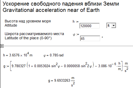

I think the sin(x)^n view is not correct in Mathcad:
I have solve this problem:
Can You do it?

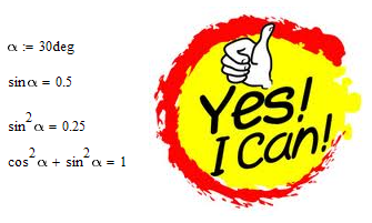

My "solution" of sin^2 for Mathcad Server:

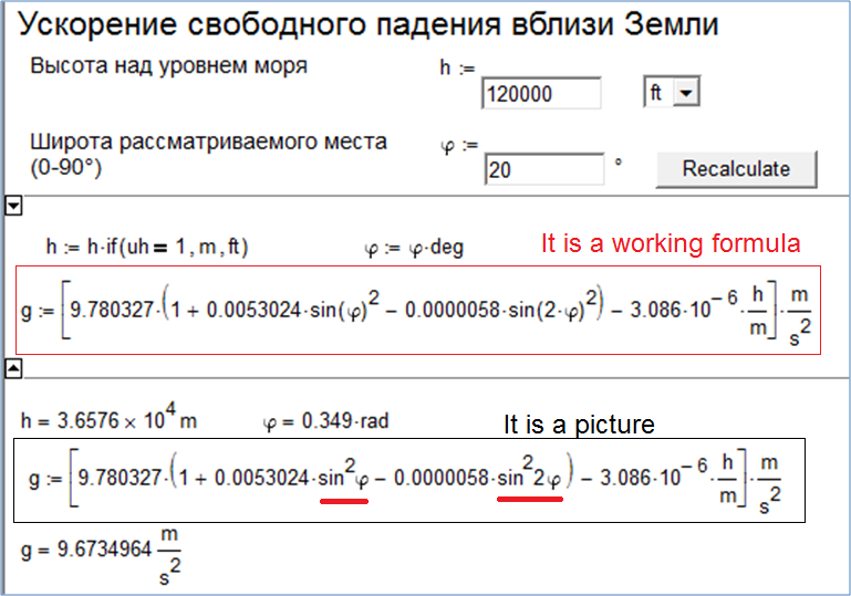

...and my solution
