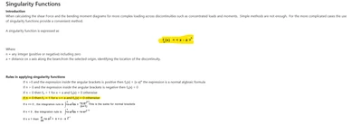

I came upon an interesting case: singularity function defined in my particular case as < r - r_o >^0
It is also said that if r < r_o then the whole function is equal to zero.
Do we have any means of evaluating this function in Mathcad, such that, if I plug inn any values of "r" and "r_o" into the function, it will return to zero (of course if r < r_o)? Otherwise this function is always 1 (if r > r_o and if we ommit the case when r = r_o).

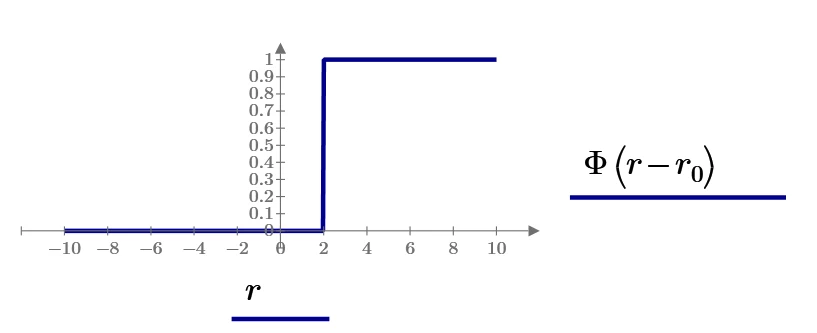

OK. I looked up the singularity functions in WikiPedia. It states that <r - r0>^0 is The Heaviside step function for r-R0, so:
This function is 'simple' in the sense that its output is 1 when r>r0, 0 when r<r0 (and the result for r=r0 is debatable, sometimes given as 0, other times as 1 and 1/2 also occurs.
Mathcad 11, numeric and symbolic:
I like the symbolic answer for F0(0,0).
Prime 11 gives:
I'm on express so can't evaluate it symbolically.
You don't get negative values for <r - r0>^n . Not when n=0, see above, but also not when n>0, because the term (r-r0) get multiplied by F0(r-r0) which is 0 whenever r<r0. So wherever you thought it would become negative, it becomes 0.

I tried it out. Mathcad evaluates function to 1 when r < r0, which is strange. Shouldn't it be -1?
I reffer to this regarding the zero value of the sigular function when r < r0. Any thoughts?
Prime 11 gives:
