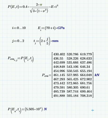

Tristan Vouga wrote:
But another problems appears here if not only E but also nu and t were to have as many different values as E. Then the multiplication and root of vectors would not work. What is the way around that?
Thanks!
Tristan
One way to deal with this is, for example:
Another is to use the vectorise operator (Look in the Operators menu - the very last operator in the list - the V with an arrow over it).
Alan

Whenever you plan to do a calculation with different variable values you have to formulate all your calculation as functions dependent on those variables. Then you may call this function with different values, compare results, build tables, plot 2D- or 3D graphs, whatever.
The worksheet itself or parts of it unfortunately cannot be looped.
