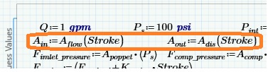

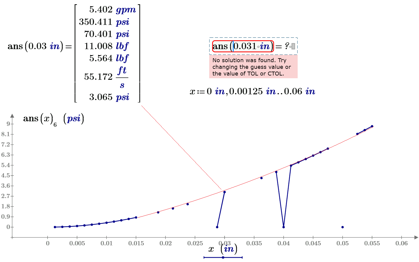

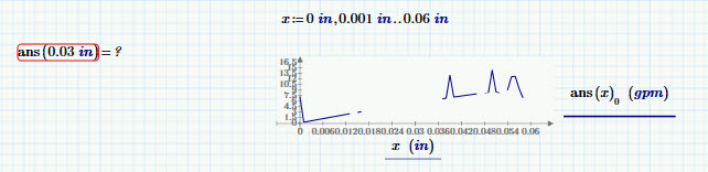

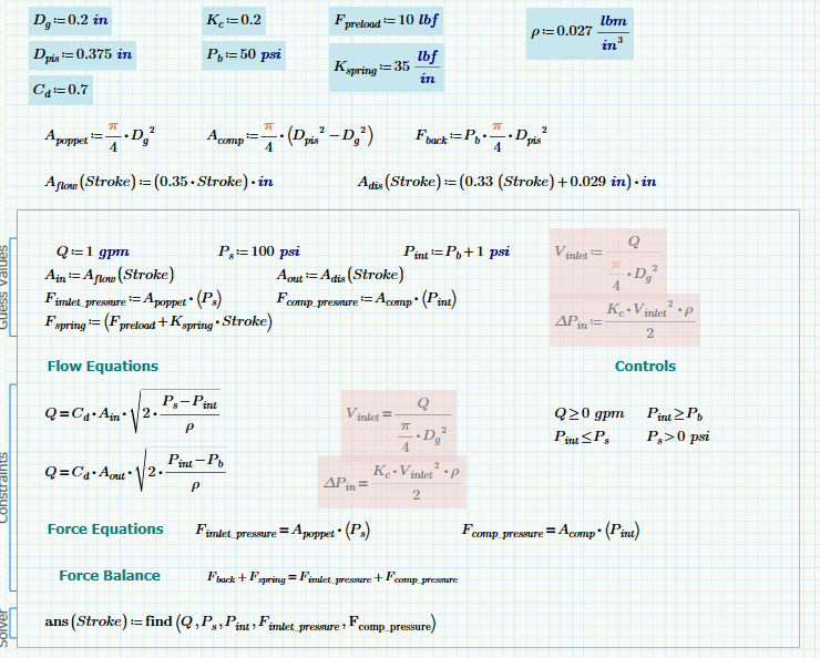

I have what I thought was a fairly simple problem, but it is giving me all sorts of problems converging.  Background: I'm solving for flow and forces on a valve to find conditions as the valve strokes.  So, I have flow through a series of orifices (solving for an intermediate pressure) and those pressures lead to forces that must balance against other forces (e.g. a spring).  So, it solves that without any issue.  Then I want to get more complicated and I use the solve block to calculate a simple parameter like flow velocity - then it starts having trouble.  Note, velocity doesn't affect the flow or force equations - I'm just looking for a value. Sometimes it will solve it, but I have to get the guesses right on.  So, am I not formulating this right?   The blocks in red are what cause a problem when I enable them.  I've tried many ways of entering the guess values but nothing seems very robust. Thanks!

It looks to me that the red areas should not be insider the solve block as the values can be calculated after the solve block.
You may create a function ans2 which first call ans an then calculates the two values.
But I guess on the other hand that those read areas should not do any harm either.
Do you mean that you get a continuous curve in the last plot if you delete the red areas and the last two entries in the find statement?

Thanks Werner.  Unfortunately there is a bit more to  the problem than what I show here that would prevent ans2 from working.  Eventually, V_inlet and it's partner DP_in would get fed back into lower the value of Ps (so DP_in is an inlet loss).  However, since I (or mathcad) struggle at this simple stage I don't have any better results with that approach even if its a true iterative problem at that point.  So I was tracing everything backwards to find when things go awry.  While it's possible they aren't necessarily the same problem, I thought this was worthy of posting since it seems to be misbehaving.   As to your second point - yes - if I delete the areas in red I get a continuous curve (it would then be identical to the first solve block).

You have solution but not for all points of the range variable x. And some points has wrong solution.

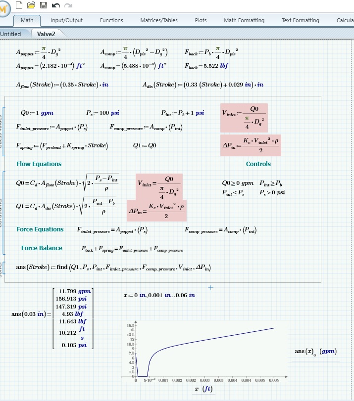

What surprises me is that in the solve block, Q is defined in two different ways. So I made a change ....
DJF16-PearlAuthor
January 29, 2017
The problem there is that Q0 isn't resolved and remains as the guessed value (1 gpm).  Switching Q1 = Q2 to a constrain (instead of a guess) and adding it to the FIND doesn't work out too well.

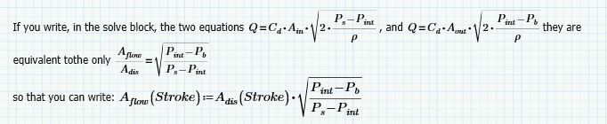

To give you a complete help I should know the analytical study of the problem. Directly addressing the problem on the worksheet, we go groping. The best way to solve a problem that creates others, is to start all over again being a little more careful.
