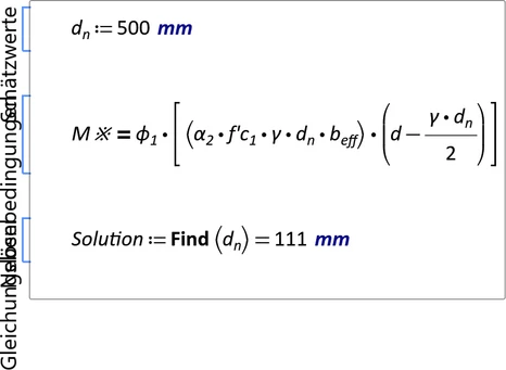

So have you found the correct equation to solve?
If its the second attempt of the above two suggestions you have to consider that there is a second solution at about 1123 mm.

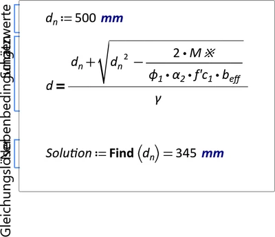

please publish the document you are using to create the Prime worksheet,
Incompatible units.  d is a length (m), the other term under the square root sign is a force (N).

Your units are incompatible in the square root expression.
I created second solve block based on your very first expression of M. This evaluates d_n.

Additional error: You let the solve block look for variable dn, but your equation is not using dn at all. I only see a variable d.
Its also noticeable that the equation you show for reference (it has no effect for the calculations) at the top contains variable dn as well as also variable d. Is this on purpose?

It also looks a bit strange that you get rid of the unit (MPa) only for f' but you leave the units unchanged for all other variables.
No idea if it makes sense but here are two solve blocks with modified equations which work.
The first one is a crude guess
The second one base on the reference equation at the top of your sheet:
