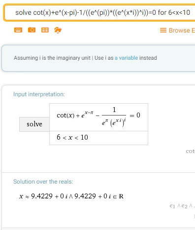

Luc, I guess there is a misunderstanding my question :
IIa.PNGI need a explanation about how to get the second solution, x = 6.237916547633475
see : https://www.wolframalpha.com/input/?i=solve+cot(x)%2Be%5E(x-pi)-1%2F((e%5E(pi))*((e%5E(x*i))%5Ei))%3D0+for+6%3Cx%3C10
Best Regards.

I need help explanation about the Missing solution - How to get the second solution x = 6.237916547633475 from that formula, from that hint.
Best Regards.

Or : I need help explanation about the Missing solutions - How to get the other solutions from 6<x<13,  from that formula, from that hint.
Werner_E25-Diamond IAnswer
November 2, 2018
Guess you found out that uncle Wolfram isn't perfect, either.
You get different solutions depending on if you chose 6<x<10 or 6<x<13 and you get the same solution twice - too bad!
For another funny effect you may click on "More digits". All in a sudden Wolfram offers two more solutions and both are not within the constraints.
Looks like the world isn't perfect and math progs aren't, too 😞

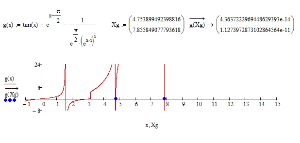

lvl10720-TurquoiseAuthor
20-Turquoise
November 2, 2018

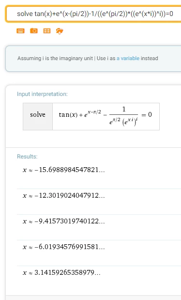

Yes. I guess so, Werner.Smiley HappySmiley HappySmiley Happy  and anyway I guess we would have to solve it "by hand" with root function and guess values. And another example :
https://www.wolframalpha.com/input/?i=solve+tan(x)%2Be%5E(x-(pi%2F2))-1%2F((e%5E(pi%2F2))*((e%5E(x*i))%5Ei))%3D0
b1.PNGb2.PNGRegards.
