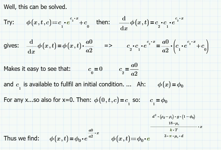

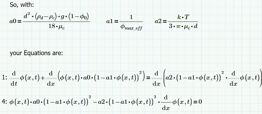

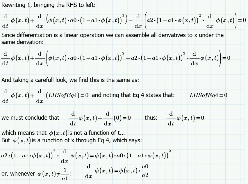

My results, analysing your equations:
Unfortunately, the coefficient of x in the exponent is positive, and large (about 23 million /m), which means that the function goes steep to infinity...
I don't suppose this accurately models your phenomenon...where did I, or you, go wrong?

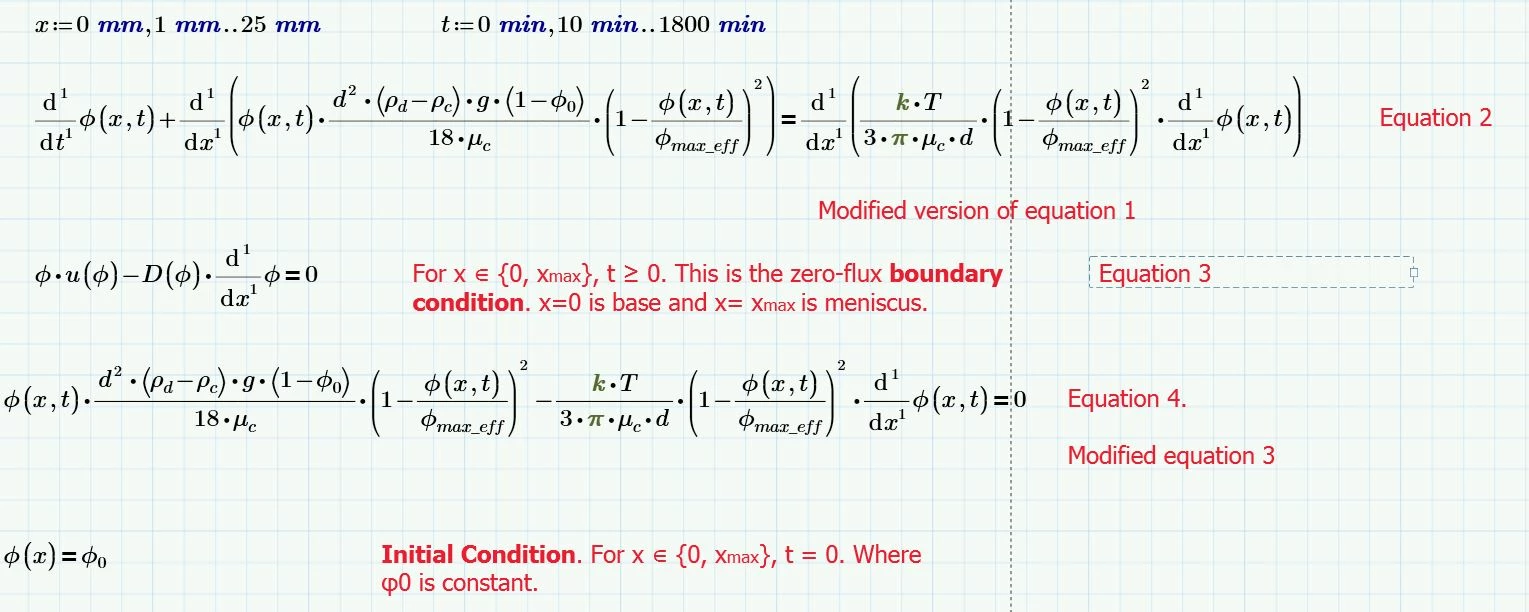

            There is a slight confusion with your solution. The equation 4 that I had written is a modified version of equation 3 and is a boundary condition. Therefore I don't think phi (x,t) is independent of t.  The derivative of the expression may be 0 at the boundaries but not everywhere else. Volume fraction will change along the solution length as sedimentation takes place with time. I am attaching the mathcad file with my comments. Take a look.

I guess you're right, I mistook the "x ∈ {0, xmax}" (= just 0 and xmax) for an "x ∈ [0, xmax]" (=the entire range from 0 to xmax).
 Sorry about that.
