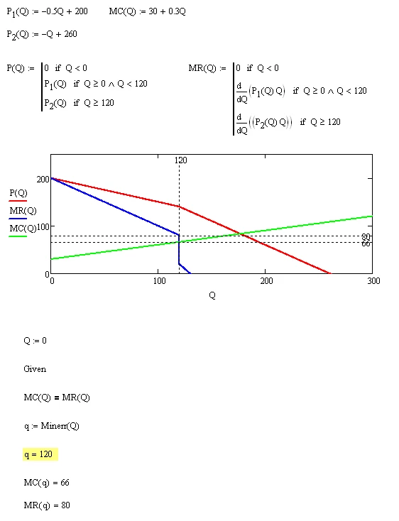

Hi...
Can someone tell my why I can't use solver together with programming tools? Or show me a solution?
I have attach a file with the problem.
Thank you...

Hi Rasmus,
Unfortunately given the discontinuity at 120 there is no solution.
As Q increases towards 120, MR takes the value 80; after the step - at 120 it becomes 20.
Regards
Andy
