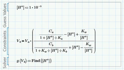

I have a solver block with an equation and a function
Further down the worksheet I define two ranges of values, x and Vb. Both ranges have values in the range 0-20.  g(x) returns values but g(Vb) shows as
I am attaching the worksheet and an Excel workbook which contains the expected results.

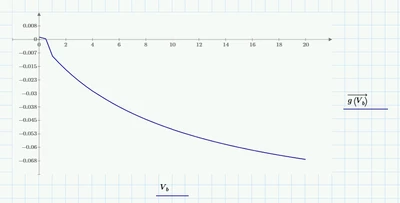

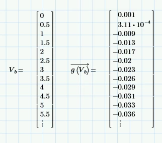

By evaluating the ranges you defined for the part of Vb, you've changed the ranges into vectors,
Seems that Prime wants you to vectorise the call to g(Vb):
Look up vectorise (in the bottom right corner of the operators, tableau) and see your result.
Then this could be the plot:

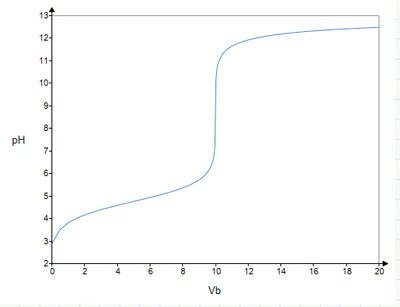

Thank you, Luc. I'm not sure why the vectorisation is necessary but obviously it is.  Anyway, I then used
I had to experiment with different guess values in order to get the correct results over the whole range of Vb but 1E-10 seems to work well and I can get a plot like this
This is my first Mathcad project so I would appreciate a little more help.  I would like to calculate pH directly rather than solving for H+ and then converting to pH and I am not sure what changes I would need to make in order to accomplish this.
