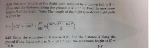

Trying to solve this equation in mathcad prime, i just cant get the form right, i keep getting an error when I know it should be a simple operation.
It has values S (total distance traveled) and X (horizontal distance traveled) known, trying to solve for the max value of H (height) of an object in parabola projection.
I keep setting the variables, guess for the H variable, and then try to solve the equation using Find(H) or Maximize(H) doesnt work. I'll attach an image of the problem. Any help would be greatly appreciated!

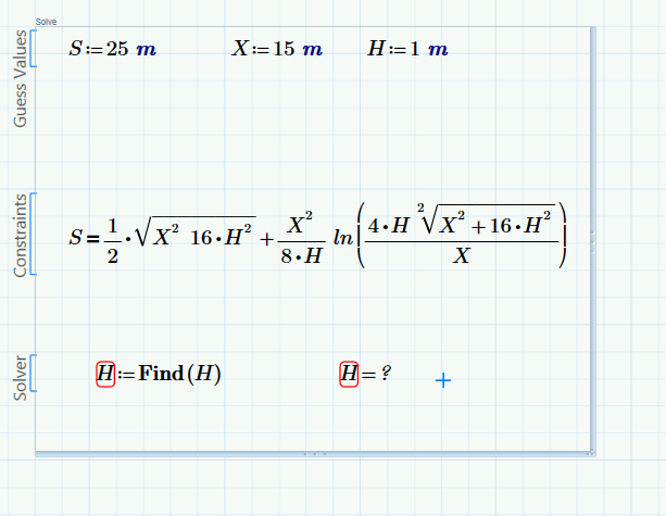

Here is what I have

Hello, Samuel,
Do you have another source for the form of the attachment, because even with other software it is not H.
Do you have any worksheet to send.
As you noted Arbiter, the units are not consistent.
Cordially.
