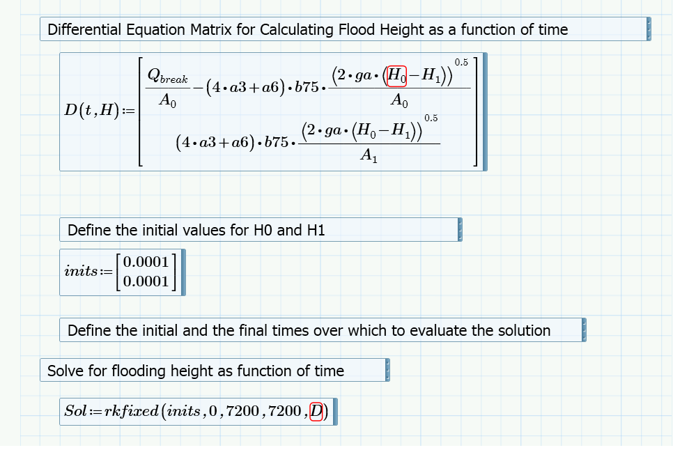

I am trying to solve differential equations for water flood height calculation.
I followed an example written in previous Matcad and tried to modify it to fit with Mathcad Prime 2.
I don't have the original matcad code, only the print out.
Somehow I couldn't define the equation for dH0/dt and dH1/dt correctly in Mathcad Prime 2. Have tried to see the tutorial example but didn't suceed in define the differential equation.
Thanks for your help
Krisnandito
Best answer by ValeryOchkov
H must be a vector - H[0 and H[1.
0 and 1 are not a subscript - see the attach.

More correct solution (with units) in attach.
You can use the odesolve function too (see attach).
In this case you have the solutions as not sets of values but as functions.
June 18, 2012
Here is the final solution. I added more remark, revised the differential equation and initial condition, and used ODEsolve to find the time when the MCR (H1) reach 4". Thanks to Valery.

Sorry, you can find "MCR (H1) reach 4" by using a root function - see the attach.
