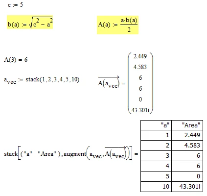

Its a long standing wish that we'd like to be able to turn a worksheet into a function but until now no development steps were made in this direction.
All you can do is to turn all your equations into functions depend on the variable you'd like to change. So at the end end you could call the final function  with a set (vector) of different input values.
I am aware that rewriting the 5-page calculation can be quite cumbersome and may also destroy the clearness/readability of the calculation.
Here is a very simple example of what I am talking about.
Instead of making the calculation straightforward
you turn them into functions of the changeable input variable a and create a table at the end:

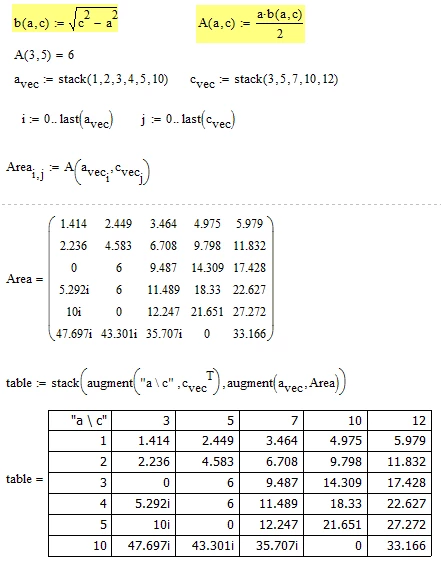

Making the calculation depended on more than one input works the same way:
