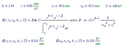

I am trying to solve an equation like:
this one can't be solved analytically and a priori the solve block does not work correctly (in the way I use it.
see attached file
Any idea how to solve this equation

I have followed your advise and evaluate first the integral and than insert it in the equation for the E-field.
I do not understand why, but this cuts the calculation time significantly and allows the use of a programmed loop.

I think that you can iterate and approximate a better solution.  Attached is your file (very nice, BTW) with my scribbles on the end.  I have only Express, so a solve block won't work for me, but the root function is a nice   alternative.  Now, the problem with this solution is that it forces a constant value for E, so the integral isn't right.  So the first iteration is to replace that constant value in the integral with the solution value.  This yields a significantly different curve shape.  I did one more iteration (you can continue to iterate, plugging in each successive solution to get the next.  Whether or not this produces a better answer or not is beyond my scope.
File in Prime 7.0 attached.  Good luck!

Apparently you need a mightier Mathcad to solve this:
The numeric solution of your solve block is close.

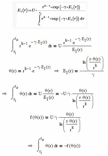

The solution is pretty obvious. With E and gamma not dependent on r, you can take the exp(-gamma*E) out of the integral, and cross it off against the same in the numerator. The primitive of r^(k-1) is r^k/k.
Now to eq(1), If you take the derivative of both sides to r, you get a differential equation which may be solvable.
Here's one try:
Solve it to get:
Prove this solves the differential equation:
OK. The next challenge is to determine the integration constant c1.

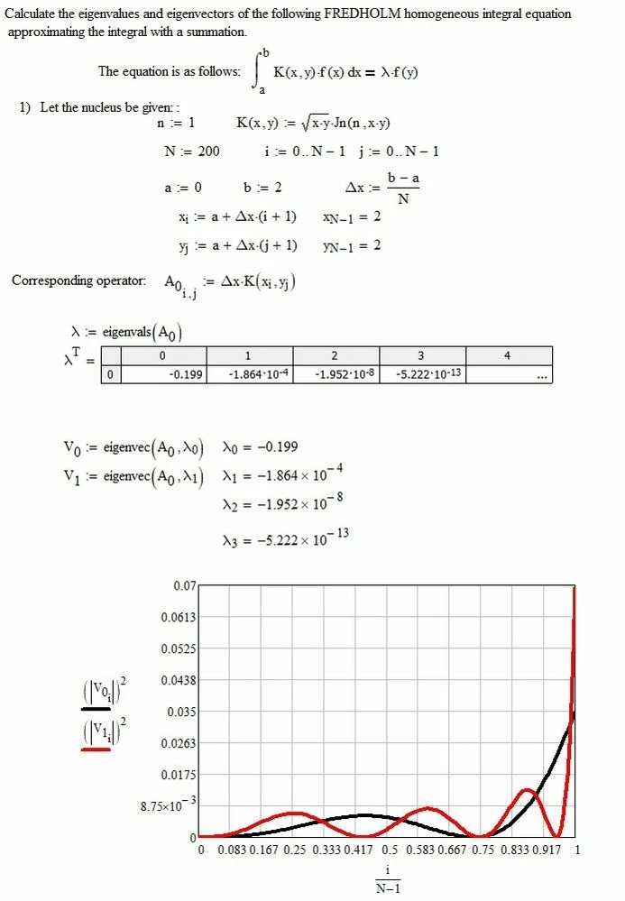

Since, in the equation, the unknown function appears as an argument of the integral, then the equation is an integral equation. You have to see what kind of integral equation it is (for example Fredholm, Volterra, Wiener-Hopf, ...). For a numerical solution you simply have to discretize the integral which becomes a matrix. An eigenvalue equation should come out. Anyway, search the internet for integral equations.
-MFra-

An elementary example of a numerical solution of a homogeneous Fredholm equation. The discretized integral equation is transformed into an eigenvalue equation. The eigenvectors corresponding to each eigenvalue are the discretized orthonormalized solutions of the given integral equation.
