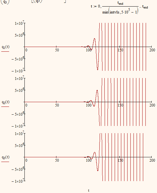

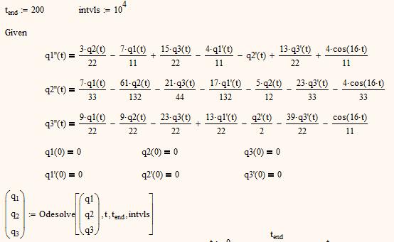

This one really tickled me and so I tried it in Mathcad 15 (without units).
1) The vector/matrix equation unfortunately does not work. Mathcad insists on separate equations (I tried with a system I got a solution with separate equations but an error if written the way you did) - thats really a pity as that way of providing the equations would be the most comfortable and elegant one.
2) Now I turned the the matrix equation in three separate ones but still no success. Mathcad often is a bit picky when it comes to which derivatives we provide where. I guess it didn't like more than one second derivative in one equation.
3) I solved the three equations for the three second derivatives, set up the three new equations and - Bingo! It worked. Find attached the MC15 sheet along with the converted (and edited) Prime 3 sheet. I am sure you may be able to add your units in Prime if you like, but be careful to do it right 😉
I had to limit the the values at the ordinate as the amplitudes really go up high. See here a plot with a logarithmic scale at the abscissa.

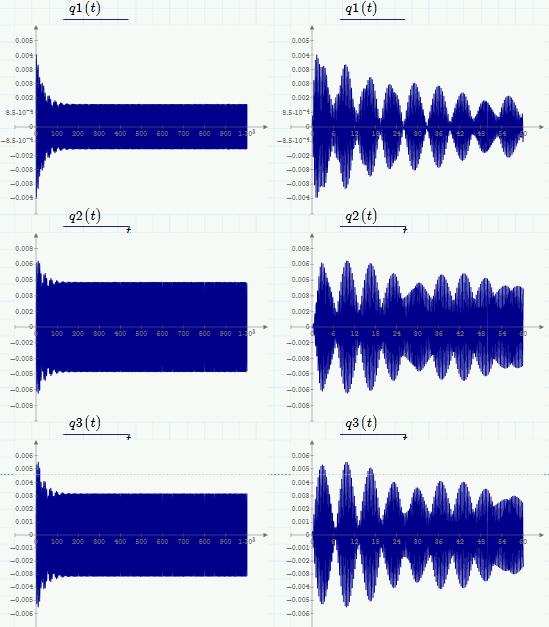

I guess I made some errors in the files posted above. At least I forgot to consider that the values of K are in kN/m and not just N/m.
I worked in your original file to find a way to come to the three needed equations in a more convenient way. Find attached an approach which is at least some kind of semiautomatic. There is still manual copy and paste necessary - at least I found no way to make it fully automatic unsing variables.
I tried to add your units but then the solve block failed again - not sure why, maybe I made a mistake. I leave this up to you now 😉
Does the new result look more reasonable (at least the amplitudes don't explode this time)? The pic shows the first 1000 seconds and the first minute.
