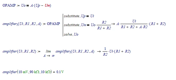

While parsing of the input file may be doable, to actually calculate voltages and currents in a given circuit requires much more. You have to have models and their parameters. Note that models differ between when you do an AC simulation or a TRANsient. If you want to be able to tackle any spice input deck, your effort will be huge, and given the fact that PRIME is not a programming language (!) I think you better crack another nut.
This is not to say that it's impossible to calculate electronic circuits, in time or frequency domain.
For a small example:
