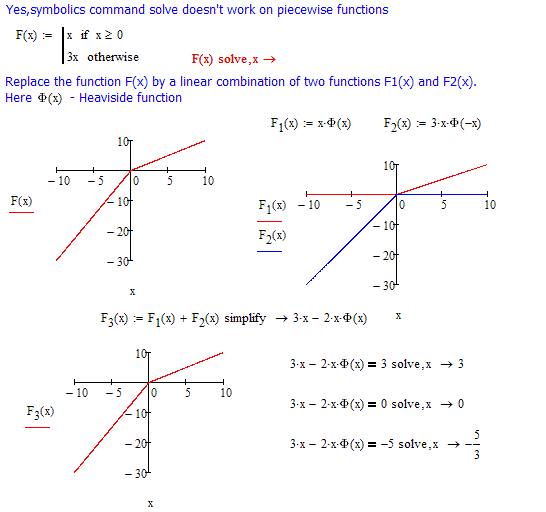

I want to solve a piecewise defined Function:
PiecewiseFunction(x):= |x if x >= 0
|3x otherwise
PiecewiseFunction(x)=3 solve --> (in the german version the word "solve" is replaced by "auflösen", so I'm not sure if solve is the right syntax there)
But this doesn't work on piecewise functions. The error message is that the value must be a scalar.
Does anyone know how to proceed in this case?
Regards
September 24, 2012
Replace the function by a linear combination of two functions.
Viktor
