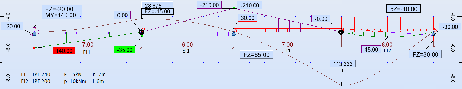

I'm trying to calculate and plot the deflection (by quadruple integration) for this beam:Projekt1.png
and after trying several different approaches I'm forced to ask for help 🙂
When I'm trying to calculate the deflection for each part of the beam separatly it works well, but as soon as i try to do it for all 16 boundary values it just stops cooperating. I suspect that I'm making some dumb error somewhere, but I just can't find it.
Any help would be highly appreciated.

Look if the attached would help.
I wonder if you really need a symbolic solution at first!?
A numeric solve block may suffice.
