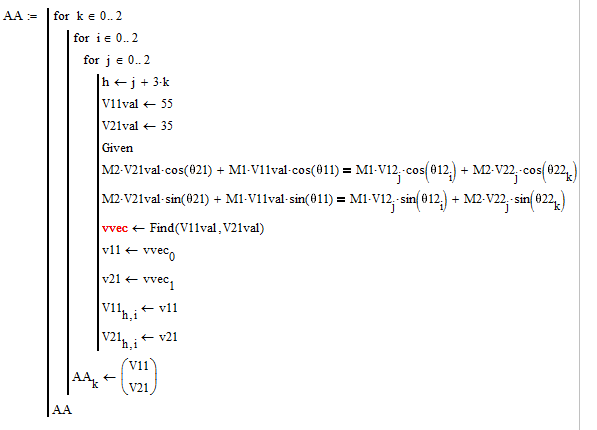

Hi all,
I am fairly new to Mathcad, and am attempting to solving a 2-D system of equations within a program block as shown below. The section of code that I am attempting to use to solve my SOE begins with
'Given'
and ends with
'vvec <-- Find(V11val,V21val)'
and unfortunately this isn't working. 'vvec' is currently highlighted in red and when I hover my mouse over it, a message is displayed saying 'This variable is undefined'.
If I use these same 4 lines of code in a regular math block rather than in a program block, they work just fine.
I'm wondering: it is necessary to use a different format when solving an SOE within a program block?
Thanks for any help!
Best answer by Werner_E
You can't define a solve block inside a program, but you can turn a solve block defined outside the program into a function depending on the parameters V21, V11, etc. and use that function inside your program.
BTW, the local variable h seems to be not in use and so could be omitted.
Please send a fully working sheet - we miss all the values of your variables M1, M2, various theta, etc.

You can create the function vvec(...):=find(...) out of the program and call it in the program.
Send please the sheet and wewill try to edit it.

This is something that I do not know how to do. Could you please give me an example of how to set up the function outside of the program, and then call it inside the program?
