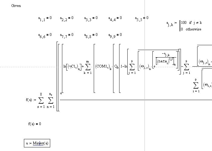

Now,i have a lot of problems in my work.i want to fit the experimental data using the mathcad built-in function Minimize(also,i tried Minerr).the function is known,there are 56 parameters in this function,i want to find them by making the objective function to be minimized.but when i run it,it takes a long time;also,when i change the guess value from 100 to 0,the result change as well.
So,my problems are:
1,how to reduce the time(do not change TOL or CTOL)?
2,the result must be Local optimum,and how can i find global optimum?
3,the mathcad built-in function(minimize or minerr),can i see how it works,or the inside result?(i know the trace function,but it traces the independent variables(x,y) if i want to trace f(x,y),how to do that? i konw a stupid way,copy the independent variables(x,y),and then calculate f(x,y),but in my worksheet,the
independent variable is a matrix{9,9},it's too complex.are there any other functions that can trace f(x,y)?

Use minerr, not minimize. Currently, you are calculating the sum of the squares of the residuals as the objective function. You need to change that so that it just calculates a matrix of residuals (don't square and sum them). I started to do that in your worksheet, but realized it was going to be a lot of work, so I'll leave it to you . So you will have a function f(a) that returns the matrix of residuals, not the sum of their squares. As much as possible, you should do this using vectorization, not iterative loops. Define this outside the solve block. Also move your guess value calculations outside the solve block. Having them in the solve block is allowed in later versions of Mathcad, but they really should be above it.
In your solve block, put f(a)=0, along with your constraints, and terminate the solve block with minerr. Right click on minerr, and set it to Levebberg-Marquardt (the other options will not work with a matrix of residuals). Something to be aware of with minerr is that the constraints are treated as just another thing to be minimized. In other words, they are soft constraints, not hard constraints. To make them act as hard constraints weight them very heavily. So for example make your first constraint (a[1,1))*10^16=0.
Doing the above should speed it up a lot. The time required for a least squares fit goes up as the square of the number of data points and the square of the number of parameters though, so it's still going to take some time.

i have tried Minerr before,it takes more time than minimize,of course,i choose the Levebberg-Marquardt.minerr.jpg
is there any mistake?
i think the reason that it takes so long time is that the function may not fit the data very well,it can't reach the accuracy(TOL=0.001,CTOL=0.001),so it try again and again.if i can trace the value of f(a),maybe i can find the answer,but the trace function can only trace a.i am going crazy

Yes. Your objective function returns the sum of the squares of the residuals. Not only does this make minerr very slow, it sometimes does not even converge to the optimum solution. Your objective function should return a vector or matrix of residuals, not the sums of their squares. I think a nested matrix will also work, but I am not certain of that. Trust me. It will make a very big difference. This fact is mentioned in the help and the Quicksheet, but unfortunately it does not emphasize it enough.
It will minimize the sums of the squares (since it's a least squares routine!) but there is no guarantee that it will reach any given value. I do not think you can judge the quality of the fit just by looking at the sums of the squares of the residuals (the Chi Square) anyway. It depends on the magnitude of the data, and in your case the magnitude is quite large. I always plot and look at the fractional residuals. In your case, a series of surfaces, residuals/data.
