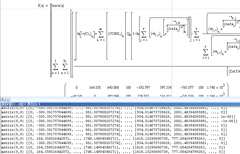

2. You can use a genetic method:
See - http://twt.mpei.ac.ru/MAS/Worksheets/Minimum.mcd
3. You can use the tarce function:
http://twt.mpei.ac.ru/ochkov/Mathcad_14/Chapter4rus/4-39-minimum-Trace.PNG

i have tried trace function ,but it is used for tracing independent variables(x,y),if i want to trace f(x,y),how to do that? i konw a stupid way,copy the independent variables(x,y),and then calculate f(x,y),but in my worksheet,the
independent variable is a matrix{9,9},it's too complex.are there any other functions that can trace f(x,y)?trace.png
