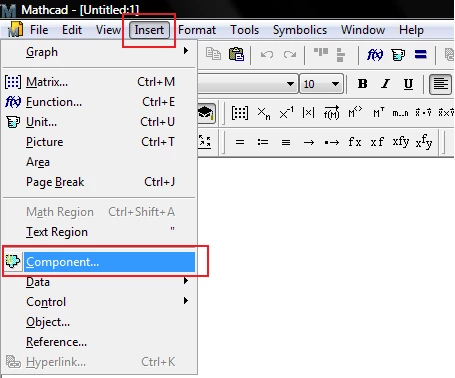

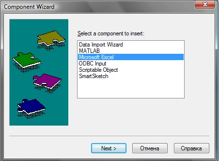

Try to embed and work with a Excel component in the Mathcad worksheet (in main menu go to "Insert" -> "Component..." -> "Microsoft Excel"):
February 27, 2012
Thanks Vlad. It looks like Excel is not very happy with nested Arrays though.
Looks like I will have to "unest" the array, store it, and then "renest" it to feed it to the calcs.
Thanks again for your advice.
