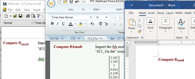

What I find interesting, and highly disappointing, is I've just converted a Mathcad file to Prime 8, of course getting all the original sub/superscripts to be removed from view. Yet they seem to still be embedded in the text! If I copy the text term from the converted Prime 8 file that originally had a subscript from Mathcad 15 and paste it into a MS Word document, it displays properly as a subscripted text field! See the progression, left-to-right, below in the image - Mathcad 15-to-Prime 8-to MS Word. So clearly Prime 8 understands this text to contain a subscripted text element, but can't/won't display it properly...good grief - PTC, why can't it be displayed properly?

Feb 10, 2023 4:26 PM UTC
