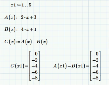

November 19, 2019
Other than that (above). Here is what I get from your description:
Where is the problem?
In other words: Post your worksheet (or a worksheet that at least shows your problem).

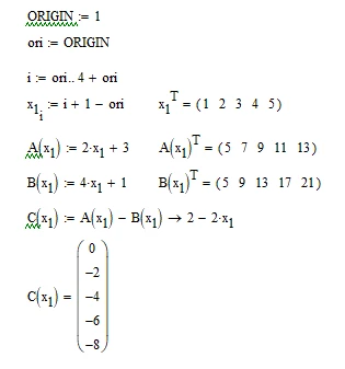

November 19, 2019
Maybe the following screenshots helps. Otherwise you should attach your worksheet (and state which version of Mathcad or Prime you are using).

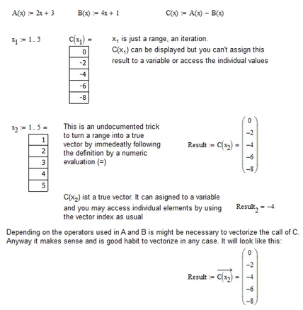

November 20, 2019
Although I have used Mathcad 15, the results are the same as those obtained with Prime 6. See below:

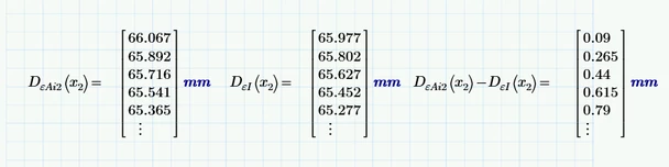

Here is the original problem:
The first two contain 27 elements, the last 729. But I don't understand why? I want to subtract every single element so that I get 27 elements in the result.
I sent the file with it. The problem is at the  end.
Thanks a lot!
