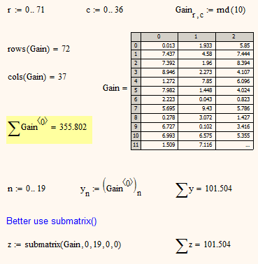

I'm trying to process a set of data that I have for limits generation. I am using MathCad to validate some limit generation algorithms that we will be using in a software tool that we are developing (no relation to Mathcad).
So, I have a problem:
The summation function only seems to work on matrixes and tables of less than a certain size:
If I define y_n to be a subset of the tables that I have, I get a summation. But if I try to sum an entire column, I get the error you see.
I have tried using a for loop to manually sum the elements of the table, but I get the same result as above. I will also get an error if I set the range variable n (in the screenshot above) to be 0...20 (or greater).
What am I doing wrong?
Best answer by Werner_E
Valery, the problem is not the way how to sum up. It works the way Jeff had done, too.
It looks like one of the elements in Jeff's matrix is a string or a matrix instead of a scalar and that throws the error.

May be so (ORIGIN=0):
June 3, 2013
I'm not trying to sum all elements of the matrix. I am trying to sum any given column of the matrix (which is very large). It appears that when the matrix is larger than a given size that the summation will not work. You should see this if you made your matrix more than 19 elements in either dimension.

Sorry I do not see a problem. One more variant of solution.

Its hard to impossible to debug a mere picture!
You should attach the worksheet or, if thats not possible as of sensible content, you should create and attach a dummy worksheet, showing the same error.
You can attach sheets
There is no limit in respect to vector/matrix sum and it should work (and does for me) the way you had set it up. And a matrix of the dimensions you are dealing with wouldn't be called large.
Best guess is that in your first column in a row with an index greater than 19 there is an element which is not a scalar value, probably a textstring or a matrix (maybe just a 1x1 matrix). From the description of your problem you should have a look at the element GainResponse[20,0.
How are the values for you matrix are generated? Is there some kind of symbolic solve or find involved? This could find more than one solution for a specific combination of parameters and so the result would be a column or row vector and not a single scalar.
Or maybe the data is read from an external file and the element happened to be interpreted as text instead as scalar number.

The problem is that I cannot just upload the worksheet because it references external files with confidential data (as Werner has suspected) that is being loaded with the file import function.
I will check this tomorrow as well as find another way to upload the worksheet if I cannot get this to work.

Have a look at the attached. I have used a couple of user defined functions and it works for over 20 elements.
