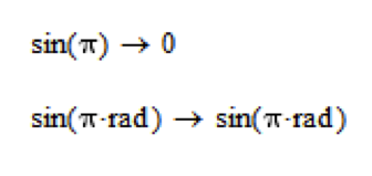

The reason is that symbolic engine does not know what 'rad' or 'm' or any other unit is. Specifically, PTC Mathcad tries to symbolically sin(Pi*rad) and sees 'rad' as undefined symbol and not 1. This is same in Prime 2.0 and 15.0:
When you use :=...= expression, defining Untitled.pngis the same as definig Untitled.png. Similarly, defining Untitled.pngis the same as definign Untitled.png.
The latter is where 15.0 and Prime 2.0 differ. To see advantage of Prime 2.0, consider:
Bottom line: :=...= is _not_ just a convenience for displaying values, but it affects semantics (of symbolic evaluation).

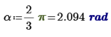

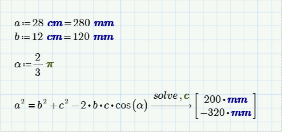

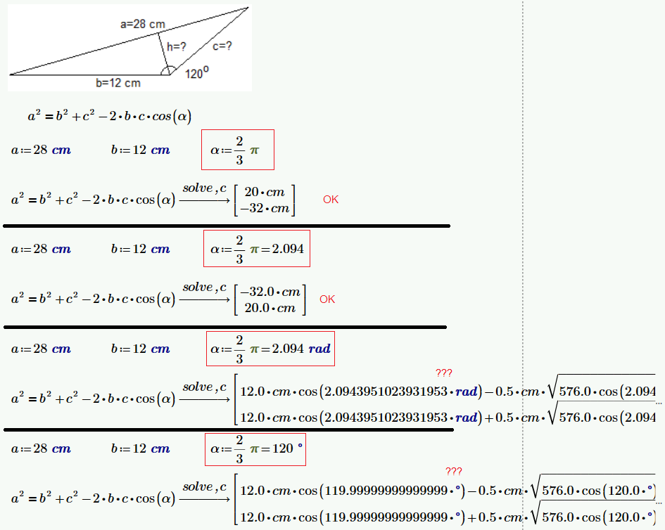

But the questin was why all ok is in MC15 and not ok in Pime - see my pictures above.
Again dynamic units?
...:=...=... and ...:=... ...=... must be equal.
