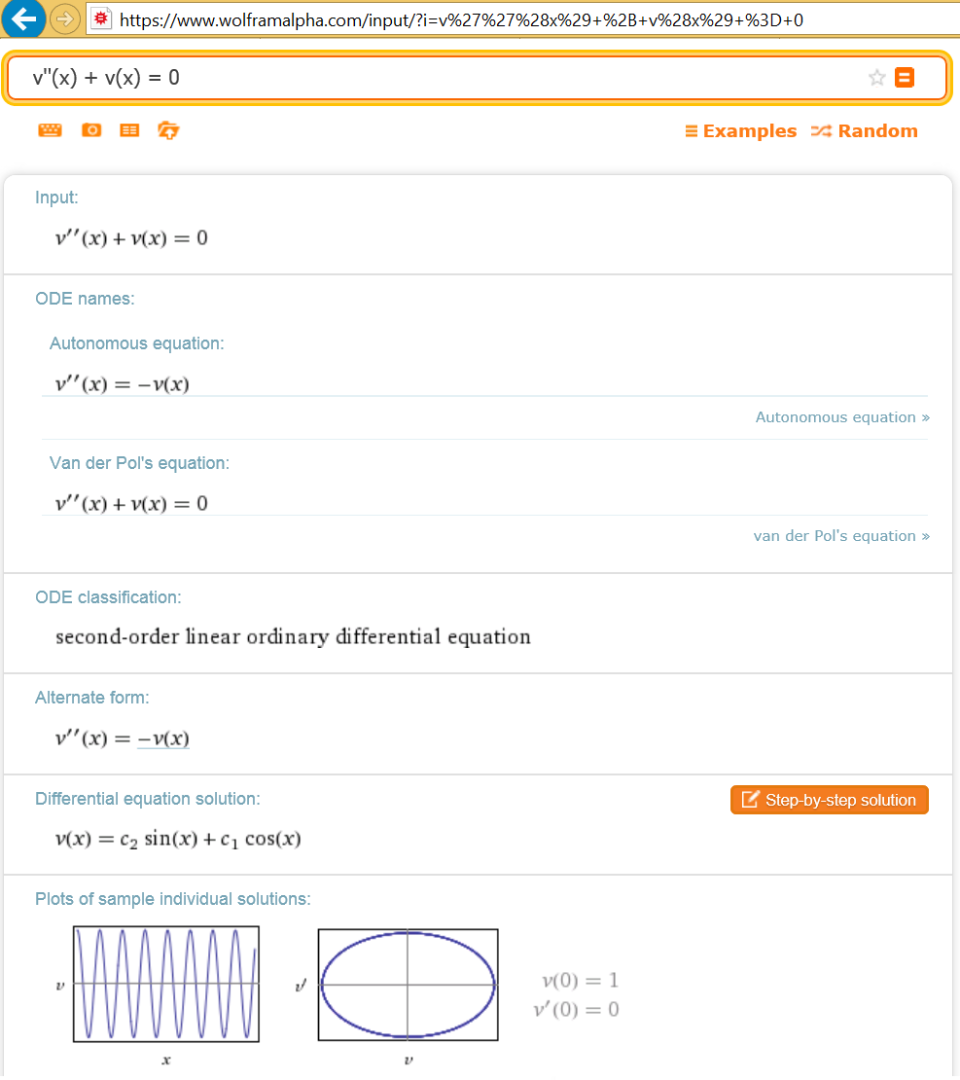

Hi Valery,
Thank you, yes I agree that Maple and Wolfram Alpha give the correct result. However, Mathematica gives the result in non-standard exponential terms. The question however was - is it possible to produce this result symbolically with Mathcad Prime 3.1 or 3? If not then the adoption of the MuPad symbolic math engine was a disastrous mistake by PTC, in my opinion, especially since Matlab now owns that technology. They would be better served by using Wolfram Alpha's API.

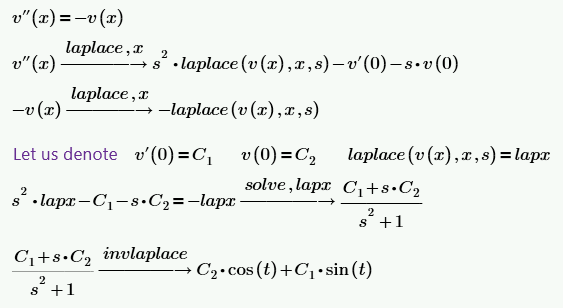

For example, we can apply the Laplace transform (in certain cases, however)
Viktor.
