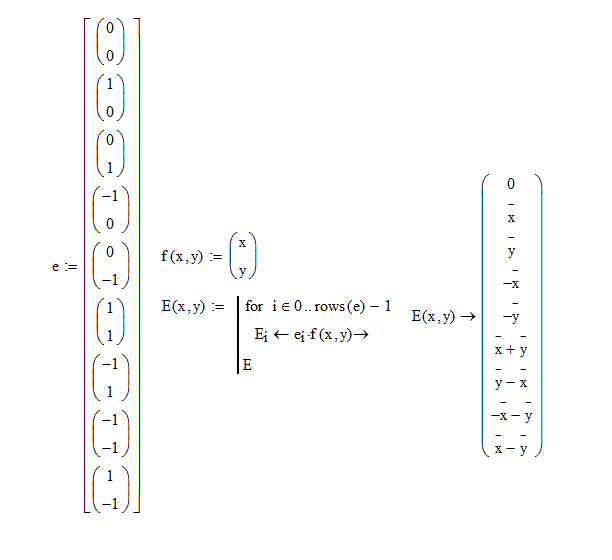

here is my question:
with reference to the .mcd file attached, how can i use nested arrays for symbolic calculation?
thanks

HI ,
Is this what you are wanting to achieve?
Regards
Andy

November 13, 2012
I'm sorry but Mathcad 15 only saves as far back as ver 11.
All I can do is attach a picure.
regards
Andy
