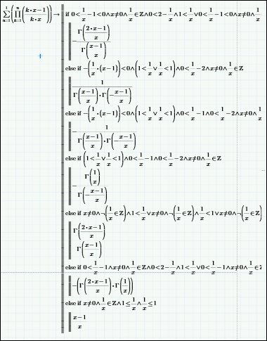

The question : Need help with Symbolic Evaluation the above.
Thanks in advance for your time and help.
Regards.

Solution in MathcadPrime 2.0
July 22, 2013
This should be simply (x-1)/x.
There's only one term in the summation, since n runs fom 1 to 1.
And with n being 1, the multiplication contains also only one term, since k runs from 1 to n=1.
So with k being 1, the one term is (kx-1)/kx, simplifies to (x-1)/x.
And that is the last line from the symbolic evaluation above
But ok, I understand your point that you do not require mathcad for this. However, when you try to evaluate the expression in M15 you get
and probably this was Loi Le's point in posting the thread.
