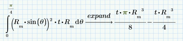

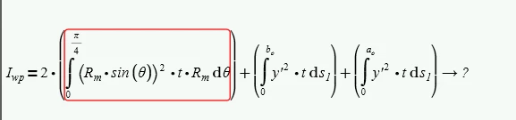

symbolic evaluation in prime 11.0.1.0
I have tried to upload the mathcad file, but it does not allow me. The following was working in mathcad 15, but it does not evaluate in prime

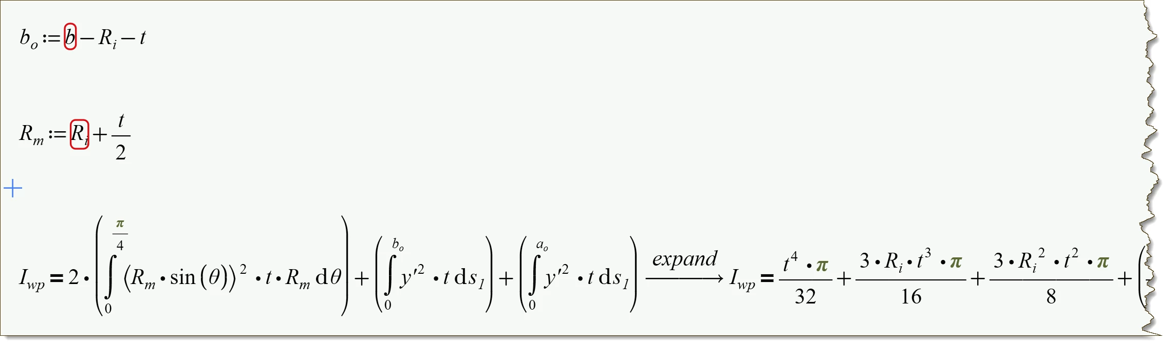

Apr 15, 2026 11:32 PM UTC
I am not sure what the problem was, but I see when I load your file that you experienced a “variable not defined” error.
But when I simply let your sheet recalculate (Ctrl+F5) the symbolic evaluations work as expected:
The two substitutions are not taken into account because you used the Boolean comparison operator instead of an assignment/definition.
If you use the assignment operator, you will receive error messages, but these come from the numerical engine in Prime; the symbolic evaluation, however, works as expected.
Or perhaps you actually intended to use the assignment operator in the symbolic evaluation as well? Also For example Iwp := 2*… .

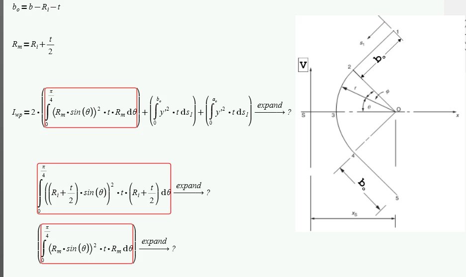

SFares14-AlexandriteAuthor
Apr 15, 2026 5:40 PM UTC
Hi Luc,
This is how I defined them:
23-Emerald V
Apr 15, 2026 8:06 PM UTC
Those aren’t definitions, they are equations (bold =). For a definition I would expect =:
Apr 15, 2026 5:50 PM UTC

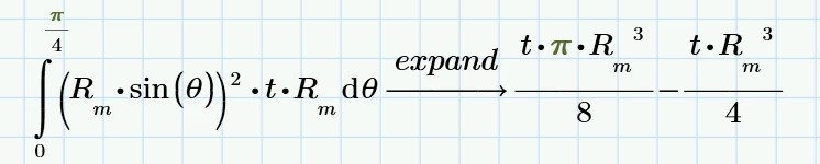

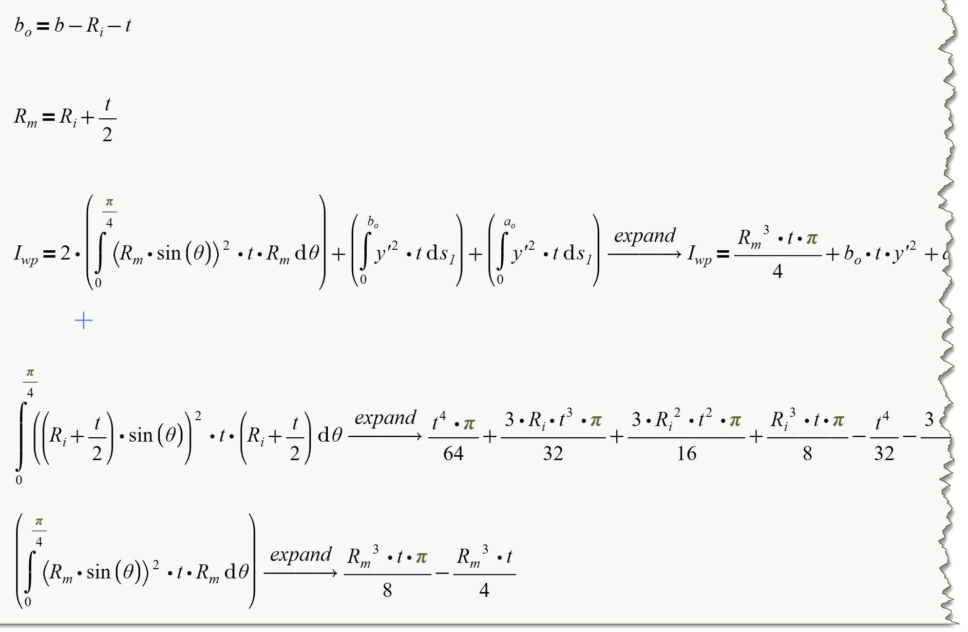

Similar to Luc’s (real) Mathcad 11, Prime 12 handles correctly:
and Prime 11.0.1.0 :
Can you upload your worksheet in a zipped file?
