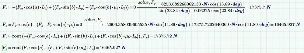

I'm trying to use MathCAD Prime 7 to solve for unknown variables in a linear equation using the symbolic solve function.
All I seem to get is the spinning yellow disc loading icon.
Can anyone help?
I have attached the file in question.

Just be patient you have done nothing wrong in your equations. Using root function is perhaps faster.

Something seems off as I've let the application run for 1 hours plus and it just will not solve. The machine I'm running this on is a cad workstation with an i7 CPU so I do not believe it's due to lack of processing power.
I sent this file to colleague of mine who's workstation is the same and is running the same version of mathcad (prime 7) and he seems to be observing the same behavior.

I tried your worksheet in Mathcad Prime 9 on a Dell Latitude 5440 laptop with an i7 CPU and 16 GB of RAM.  The OS is Windows 10 Enterprise, 64-bit.
Upon opening the worksheet, F.cs took about 2 seconds to calculate (very odd because it's a simple divide by 3), but the rest of the worksheet was almost instantaneous.  I then changed a few predecessor variables to see how fast F.r and F.s calculated, and each time it was almost instantaneous.
