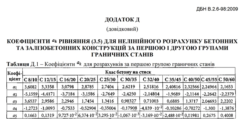

As you correctly mentioned, the moment-curvature "comprehensive" diagram could be represented by different equations:
1. Here, in our Code (Ukraine) two possible ways are possible (formula (3.4) or (3.5):
Where ak- polynomial coefficients (5), for each grade of concrete, is taken from Appendix D

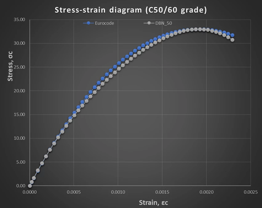

The difference between the curves, realised by our Code and the formula, which is used in Europe, may be in the USA, if I'm not mistaken, is not significant. To prove this, I compared the two curves in Excel.
As you can see, both dependencies are pretty similar and close to each other.
