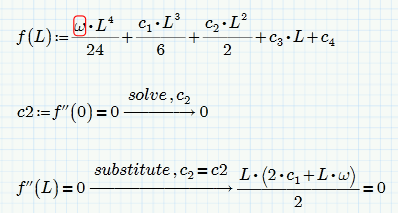

Can a variable's symbolically obtained value be propagated to future uses of that variable?
I want my second expression to see c2 as zero.

Yes, but not like that. The symbolic evaluation gives f''(0) as c2. The boolean equals and the 0 have no effect at all, they are just cosmetic, so c2 has not been assigned any value. The only way to assign a value to a variable is with a numeric assignment. That can be coupled with a symbolic operation, for example a solve, but in your case I can't tell you exactly what to do without seeing more of the worksheet.

I've attached a simplified example of my question. If I want to use "x" later in my worksheet I have to redefine it after it's symbolically solved.
If my "y" or "w" variables change, the new value for "x" is no longer propagated.
Is there a technique that would keep me from refining "x" every time is value is effected?

December 21, 2015
Use a numeric assignment with the symbolic solve:
