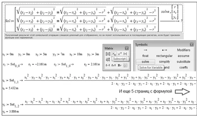

I would like to solve a system of equations, but I receive the error "The symbolic result is too large to display". I need the symbolic result, because I would like to calculate the parameters of the electric circuit for which I wrote this system of equations. I'd appreciate it if you could help me with this issue.

You can turn the result into a function of the unknowns.
Use "result(xIcb0, xbeta,xR1043,.....) := [  ] solve... "
You will still get the message about the expression being too large, but you can use that function an can evaluate it numerically for any value of the unknown variables.
