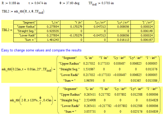

Attached is a mathcad14 sheet.Is it possible to have mathcad generate a table after the automation of the calculation? the table is shown on the right. I did set up some equations on the left side that gives some of the values in the table. I need to automate the process because i am repeating the same steps for each element. Thanks!

I am not sure but it looks like he is just after a neatly formatted table as he is possible used from spreadsheets.
So as I understand every set of (r,t,theta,TF) would yield a table as he had made by hand.
In this can be handled by a matrix which can be formatted as table or as marix as shown below, but you won't be able to achieve the look and format comfort of Excel.
But then, I may be wrong and something else is needed.

Hello Werner,
i am attaching new mathcad file. The values in the table are calculated on the left side. is there away i could show these calculated values in table format as done by hand? Thanks a lot!

So the question is to just put all those calculated values in a nice and neat table for display?
You can't get results which would look as godd as you can make them look in a spreadsheet.
All you can do is to put all the values in a matrix. For headers, etc. you can assign textstrings to the appropriate matrix elements, but I guess the result would be far away from good looking.
As you wrote about repeating the calculation i thought you were after some kind of iteration.

Generally, a table implies changing one or more parameters in some sort of sequence. You can do that by creating indexed variables, something like i:=0;5 L<sub>i</sub>:=5*i.
Next, you can just replace the single-valued variable with the indexed variable, and get a list of results from the equation.

This looks really good. i am not expecting it to look as good as excel, but it looks very decent. Thanks!
