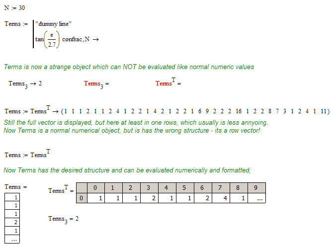

OK, there may be a solution.
Here is a clumsy way to avoid the display of the long vertical vector other than hiding it in a collapsed region.
6 replies
February 8, 2017
Unfortunately the formatting option "table" does not apply to symbolic evaluations.
So the best I could think of is to hide the expression in a collapsed region and just show the result afterwards with numeric evaluation.

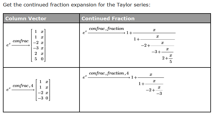

From Prime 3.0 help:

Great. The trick is worth to remember.
Don't agree : I wouldn't say clumsy, but the opposite !
Thanks a lot, Liv.
