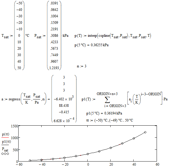

For some reason, MathCAD is telling me that it needs to be in wierd temperature units when I'm not designating any units anywhere. I still have the same problem when I cahnge T to something like Temp or T.RK
It's highlighted in dull pink at the bottom.
Best answer by ptc-4168940
Nevermind. I forgot about the R in the top. I meant to put R.spec
R has units of Kelvin or something wierd like that.
ptc-41689401-VisitorAuthorAnswer
April 29, 2013

Why do you not work with units?
So for example:
