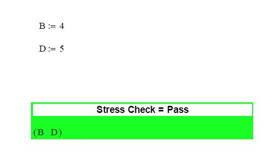

I wrote a VB script for a text box to highlight condition based on the input variable. However, when I print the mathcad file is doesn't display the color of the textbox. Is there a setting that I'm missing that is causing it to print incorrectly?
Attached a sample mathcad file that contains the script. I apologize in advance if this is a repost.
Any help is greatly appreciated, Thanks.

Is there a way to make the scripted label have a pre-defined width? E.g the width of the page.
Yes, although it's something of a pain to size the label, because you can't just drag it to the correct size.
In the script add a line
TextLabel.Caption="xxxxxxxxxxxxxxxxxxxxxxxxxxxxxxxxxxxxxxxxxxxxxxxxxxxxxxxxxxxxxxxxxxxxxx"
After the "End If". Make the text string long enough that the label is the size you want. Exit the script, select it, hit F9 to make sure it updates to the desired size. Now in the script remove that line, and set TextLabel.AutoSize = 0. It will now stay at that size. You may also want to add the line
TextLabel.TextAlign = 2
in the top section, which will center the text.

Please see attached. I have used a scripted Label component, which seems to work.
I have no idea why textboxes do not display when printing.
Mike
July 5, 2011
It looks like a bug to me.
July 5, 2011
When using the label scripted component the following command seems to be the line which makes the background visible when printing.
TextLabel.Caption = Inputs(3).Value
Textboxes do not support this function though.
Mike
