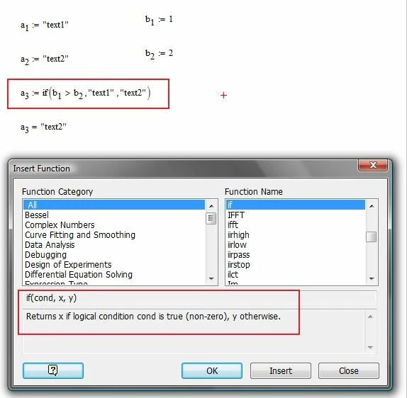

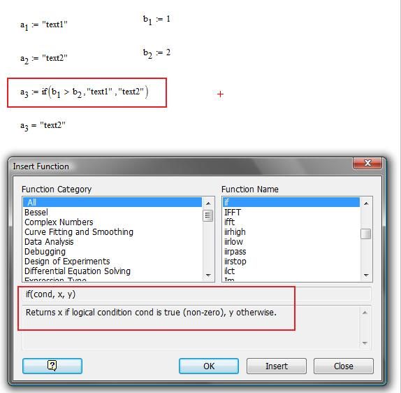

Hello!
You need to use the built-in function "if":
23-Emerald I
April 12, 2012
Not sure I understand what you're trying to do.
April 12, 2012
Thanks for the quick response
But that is not what I am looking for
I need an output with two text variables side-by side
say a1= "Hello"
a2 = "I am fine"
then the output should be
a3= Hello- I am fine
not just "Hello" or either "I am fine". Want both variables.
I guess there must be some syntax to declare the text variables side by side
