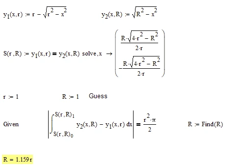

I wasn't aware of this new exact solution to the problem - thanks for bringing this to our attention.
Obviously we cannot expect Mathcad to give us the "exact" solution, but it sure is good enough for an approximation:
By the way, the wiki entry for the goat problem has already been supplemented by Ingo Ullisch's closed form solution -> https://en.wikipedia.org/wiki/Goat_problem#Closed-form_solution

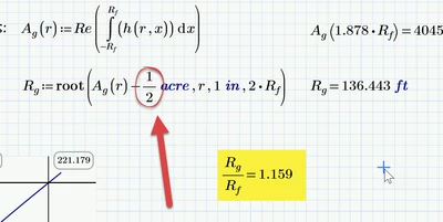

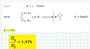

Okay, where's my mistake?
December 25, 2020
It here, as the area should be just half of the area of the fenced circle.
BTW, your function A.g(r) only returns a correct result for the area between the two circles if r<=sqrt(2)*R.f.
If the goat circle intersects the fence circle above the x-axis, you get wrong results.

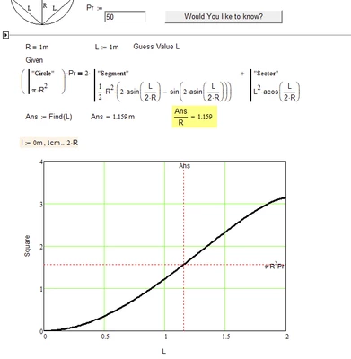

Nice idea to make the area ratio selectable.
But the link in the thread you point to is dead and the plot in the attached worksheet fails. I guess the file is from the times of the Mathcad Application Server and you added units. If you do so, you would also have to change the plot by providing a range for l and unfixing the upper limit of the y-axis:
Unfortunately the file does not show the derivation of the formula using the capabilities of Mathcad.
