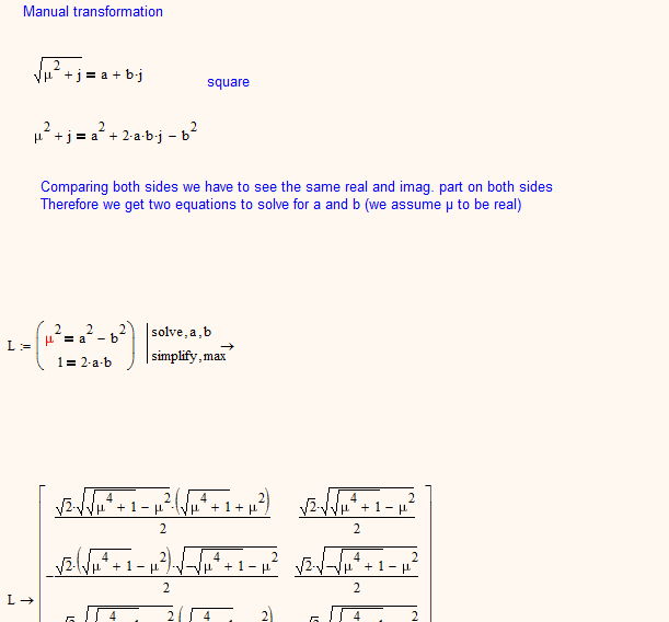

I need to calculate the semi-infinite integral that appears in the attached pdf file and the solution should have imaginary part. But, for some reason that I do not know, it is just given me the real part.
j inside the integral is the imaginery term.

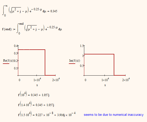

You are right, one would expect an imaginary part.
Numerical deficiency or bug? Guess the first.
Did you try symbolic eval? I had to stop - it took too long.
Werner_E25-Diamond IAnswer
April 2, 2013
Second approach using a different program (Derive 6)
Using this information, Mathcad is able to yield the correct result:
Again with the help of Derive we can rewrite your function J so that even Mathcad yields the correct results:

Sorry, as already written I have not done the transformation myself by hand but had used another math program to do the job and simply retyped it. Later I tried if Mathcads symbolics would do the trick (using the modifier rectangle) but I had no succes - maybe I tried not hard enough, as Mathcads symbilics can be quite tricky.
See attached.
I have just gave it a try and found a way to do the transformation manually with the term, that can throw complex results, using Mathcad only to solve a system of equations. Don't worry about the red errors, they apply only to numerics, we use symbolics here. It would be more correct to write L(my):=...
and a(my):=L(my)[0,0 etc.

April 3, 2013
I am not sure if we see the same, if its a version conflict (I am using Mathcad 15 M020) or maybe only a misunderstanding.
I include a worksheet with a manual proof that the expressions by derive and MC are equivalent.
Also a pdf of the file so you see how it looks for me
