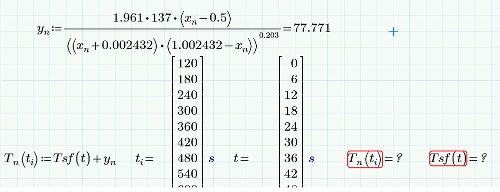

Hello everyone,
 In scenario 4, I got everything correctly. However, when I tried to graph the plot. There were an issue with "too many range variables".
I read some posts that recommend to change the number of points. However, it was invisible to click on. Would you guys please help me with this?
Thank you so much

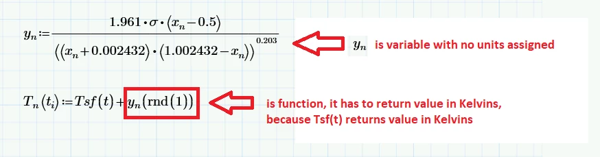

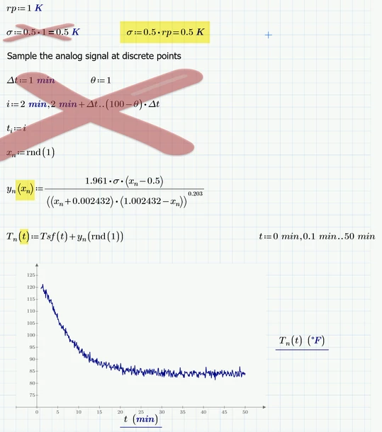

You still have the wrong definition of sigma! You compare 0.5*1 with 0.5K and the result is zero (because they are not equal) and this zero is assigned sigma. Your sigma is zero! Give it a try. Furthermore in the definition of y.n you used sigma as if it were a function.
And the way you defined and used x.n your "noisy" signal would have used the very same random number for every time - not very noisy 😉
Here is a way to do it. Do you really mean T.n to be 0 (zero what - K, °F, Delta°F,..?) for times smaller than 2 minutes? You may replace the 0 by NaN (which suppresses plotting) or by Tsf(2 min).

you must define yn as function !!!

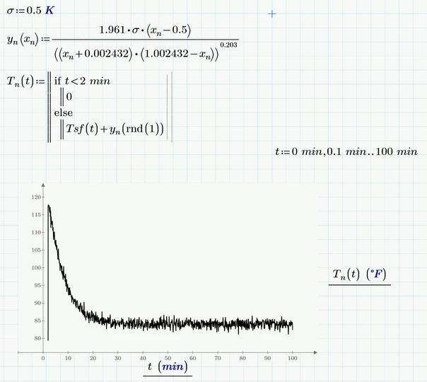

Looking for something like this?
it looks really good. But the Tn is T noise so it would start at 2 and the time interval is ti = 2,3...99. I have some new updated here.
