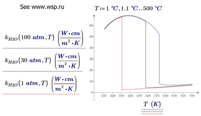

August 17, 2020
Correct unit of Thermal Conductivity W*m/(m^2*K)!
August 21, 2020
So true, Valery!  I like to keep the "youngsters" thinking of the physics behind the numbers.
