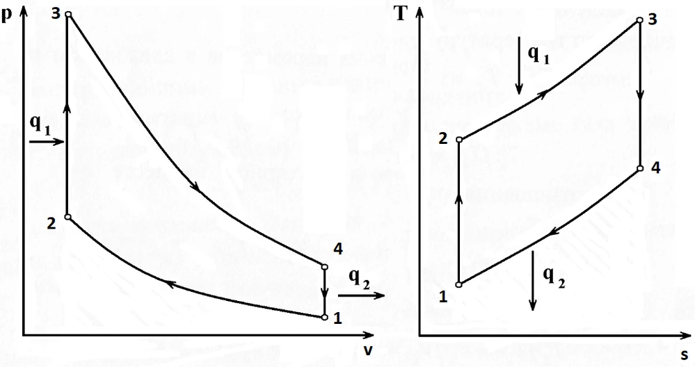

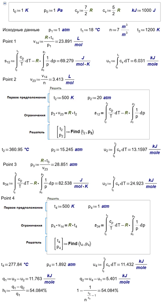

May be one example with Otto cycle help you
