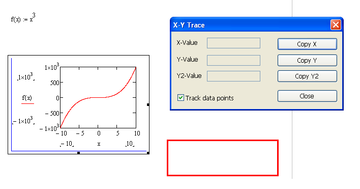

I am using mathcad 15 on Win7 pro. Open the trace dialogue, click the plot lines, but no response.
Best answer by VladimirN
Looks like it is a new bug in M020 service release of Mathcad 15. Try after the call trace window to click an empty area of the worksheet, and then point to the curve of your plot.
VladimirN24-Ruby IIIAnswer
June 23, 2013
June 23, 2013
It works!
Click please out ot the plot and than in the plot - on the curve.
(Mathcad 15 20.0 + Windows 😎
July 2, 2013
Reported to R&D as SPR 2162871.
WORKAROUND:
* Left click on the graph after selecting the Trace option
* Press one of the arrow keys once (Left or Right arrow) from keyboard
* Try to trace values now using Mouse as usual (by holding the left mouse button).
